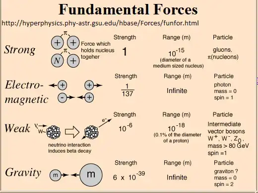

Gravity is the weakest on the quantum scale out of the four fundamental forces, that is, the strong and EM forces are much stronger, keeping matter intact, so you do not see spaghettification here on Earth.
