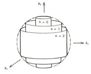

Landau tube
We can find that for a fixed $n$ and $k_z$, the states of the same energy are just denoted by a circle with centre axis along $k_z$ axis and satisfying $\frac{\hbar^2 (k_x^2+ k_y^2)}{2m}=(n+\frac{1}{2})\hbar\omega_c$.
Here is my question : Are the coordinates of Landau tube ($k_x$, $k_y$ and $k_z$) corresponding to three components of mechanical momentums ($\hat{\vec{\pi}}=\hat{\vec{p}}+e\hat{\vec{A}}$) or canonical momentums($\hat{\vec{p}}$)?
If they are mechanical, why can we use both $k_x$ and $k_y$ to label a state when $[\hat{\vec{\pi_x}},\hat{\vec{\pi_y}}]\neq0$?
If they are canonical, why can we easily find the states of same energy by satisfying $\frac{\hbar^2 (k_x^2+ k_y^2)}{2m}=\left(n+\frac{1}{2}\right)\hbar\omega_c$ when the form of Hamiltonian is not simple $\frac{\hat{p}_x^2+ \hat{p}_y^2+\hat{p}_z^2}{2m}$?

The coordinates of the Landau tube should be the canonical momentum, since you have already replaced the vector potential in the kinetic momentum by $Bx$ which led to the displaced harmonic oscillator in the $x$-direction. And note that your mechanical and canonical momentum are essentially the same in the $y$- and $z$-direction.
With respect to your follow up question, I am not quite sure if I understand it correctly, but, the simple form $\frac{p_x^2+p_y^2+p_z^2}{2m}$ is the Hamiltonian for a free particle in all dimensions which is apparently not the case here. Thus the energy has the constraint that $\frac{\hbar^2 (k_x^2+k_y^2)}{2m} = \hbar \omega_c(n+\frac{1}{2})$ and is not simply given by $E = \frac{\hbar^2 (k_x^2+k_y^2+k_z^2)}{2m}$.
