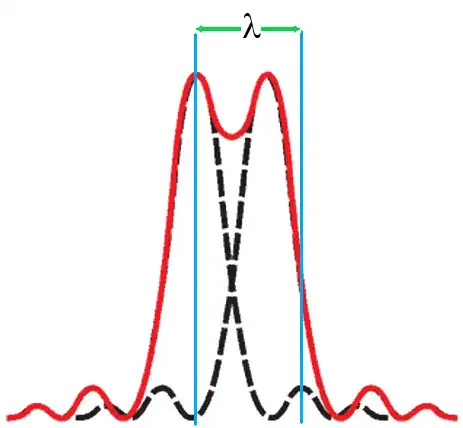

That concludes the proof, I understand all of the proof except why the part marked red is $1$ instead of $1/2$. According to the proof above, I'm to understand that the next minimum is $\lambda$ away from the first maxima,
Rayleigh criterion 2
But, $\lambda$ away from the central peak is a maxima (not a minima). So it just seems nonsensical to say that the next minimum is a distance $\lambda$ away.

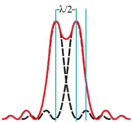

This is the situation I had in mind: Rayleigh criterion 1
From the image above I note that the next minimum is $\lambda/2$ from the central maximum, and as per the Rayleigh criterion, the maximum of the right peak is directly above the next minimum of the left peak. Which is precisely the condition (I thought was) required for the Rayleigh criterion to be satisfied.

Can someone please explain to me why the next minimum is located at a distance $\lambda$ away from the first (central) maximum instead of $\lambda/2$?

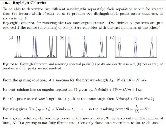

Thanks to all those that have responded to this post, in particular, @Philipp Oleynik, who was the person that made me realize that the derivation shown may be incorrect. Since then I have done further research into this and noticed that the same professor that wrote the derivation above has written the derivation for the Rayleigh criteria in a slightly different way in a subsequent year of lecturing. Here is a copy of the professors' derivation of the Rayleigh criterion:
New Rayleigh criterion derivation
Once again, I understand all the steps apart from "Its next minima has an angular separation $\delta\theta$ given by, $$Nd\sin\left(\theta+\delta\theta\right)=\left(Nm+\color{red}{1}\right)\lambda_1"$$ For the same reason as before, I think the $1$ in red should be $1/2$ which is the condition for destructive interference as required by a minima.
Last time I checked minima occur when the path difference is a half-integer multiple of the wavelength and not an integer multiple. So the update I have provided has changed nothing. The question still remains; why is it a one and not a half?

When you write,
$$ Nd\sin\left(\theta+\delta\theta\right)=\left(mN+\color{red}{1}\right)\lambda,$$
it doesn't mean the minimum is located $\lambda$ distance away from the maxima at angle $\theta$.
This just means that in order to get a minima of intensity at angle $\theta+ \delta \theta$ for light with wavelength $\lambda$, the path difference between successive phasor contributions, which is $d \sin (\theta+\delta \theta)$, should be $ m \lambda + \lambda/N$.
Alternatively, in the language of phase angles, one can say that the phasors from successive slits are oriented at an angle equal to $2\pi/N$ in this case. Together, these phasors form a regular $N$-sided polygon, so that the resultant amplitude at angle $\theta+\delta\theta$ is zero (for light with wavelength $\lambda$). See the classic vector/diagrammatic argument in Resnick-Halliday-Krane or Resnick-Halliday-Walker for this.
If you really want to find the distance of the maxima at angle $\theta$ and the closest minima on screen, that would be $D\delta \theta$ approximately ($\delta \theta$ being the result of the calculation that you've already done in the question and $\theta$ is assumed to be very small), where $D$ is the distance of the screen from the grating (assuming the two are parallel). Note $D$ doesn't have to be $\lambda N$ or anything like that, so that the distance between maxima and minima could be anything depending on what you choose $D$ to be in your experimental setting.

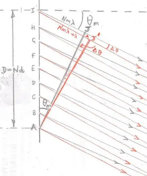

I will first use the diagram I used for my answer to the post Angular width of first maximum in diffraction grating to answer some of the questions posed by the OP and in particular why it is that the path difference between the two slits at the edge of the diffraction grating have to have a parh difference of $\lambda$ and not $\frac \lambda 2$ to identify the position of the first minimum next to one of the principal maxima.
  1. You use the term "Secondary sources", are the secondary sources the red rays and the 'primary sources' the black rays?
The sources are the transparent slits in the grating which act as coherent sources which I will assume are all in phase with one another.
The grey and red rays which emanate from the slits come from the same source within each slit.
  1. You say "lower half of slit" and "upper half of slit"; Does this correspond to one slit or lower slits A, B, C, D and upper slits F, G, H, I (as E is the central slit)?
The "hand-waving" explanation goes as follows.
Wavefront $AJ$ is $m\lambda$ from source $B$, $2m\lambda$ from source $C$, $3m\lambda$ from source $D$ ..... $Nm\lambda$ from source $I$ where $m$ is an integer and called the order of the interference.
The wave travelling in direction $\theta_{\rm m}$ produce the $m^{\rm th}$ order principal maximum.
Line $AJ'$ is such that its distance from slit $I$ is one wavelength more than the distance from slit $I$ to wavefront $AJ$.
It is this extra path length $\lambda$ which the OP is querying.
The rational for making the path an extra wavelength is that the path from slit $E$, which is in the middle of the grating, to the line $AJ'$ will be an extra $\frac \lambda 2$ as compared with the path length from source $E$ to wavefront $AJ$.
This means that waves travelling in the direction $\theta_{\rm m} +\Delta \theta$ from slit $A$ are exactly out of phase with waves from slit $E$ and this is the condition for a minimum in that direction.
But as well as slit $A$, which is in the lower half of the grating and slit $E$, which is in the top half of the grating, the path difference in direction $\theta_{\rm m}+\Delta \theta$ is also $\frac \lambda 2$ from slits $B$ and $F$, $C$ and $G$ etc.
So there is a minimum in the direction $\theta_{\rm m} + \Delta \theta$.
If you followed my reasoning you may have noticed an omission?
Which slit pairs with slit $I$?
The simple hand waving argument is to say that this is just one slit out of thousands and so the light intensity produced is minute compared with that from a princpal maximum.
Thus we can neglect it.

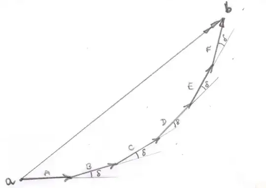

Using phasor produces less of a hand waving argument.
The arrangement which is being considered is as follows with the grating only having $6$ slits but more slits to come later.

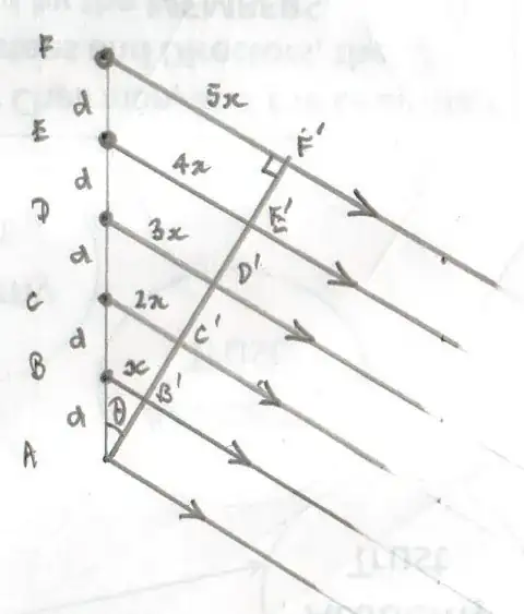

The path difference between adjacent slits is $x = d \,\sin \theta$ where $d$ is the separation of the slits.
That path difference corresponds to a phase difference of $\delta = \dfrac{2\pi d\sin \theta}{\lambda}$
The phasor diagram looks like this with $ab$ being proportional to the resultant amplitude.

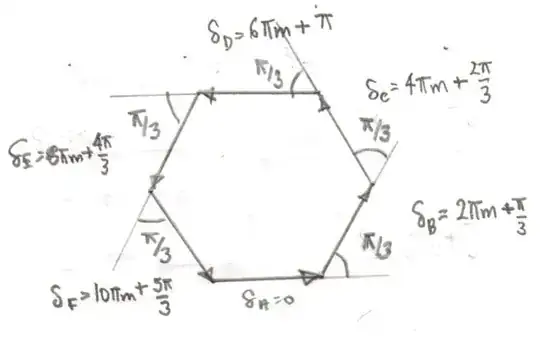

Principal maxima occur when $x = m \lambda = d\,\sin \theta$ ie $\Delta \delta = 2\pi m$ between adjacent slits where $m$ is an integer.
Phasor $a'b'$ is proportional to the amplitude of a principal maximum.
Now consider what happens if the phase difference between adjacent slits is increased by $\frac \pi 3$.
The resultant phasor is zero and so this is the minimum adjacent to the principal maximum.
Then for six slits the extra phase of the last phasor is $\frac{5\pi}{ 3}$.
If there are sixty slits that extra phase would be $\frac{59\pi}{ 30}$ and for six hundred slits $\frac{599\pi}{300} \approx 2\,\pi$ which approximately corresponds to an extra wavelength for the very last slit, the approximation getting better as the number of slits increases.
