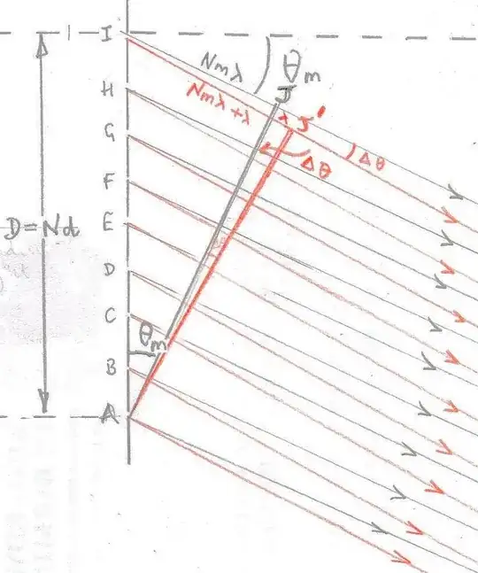

The first thing to remember is that in general the number of slits in a diffraction grating $N$ is very large so $N\gg 1$.
In the diagram below there are $N+1 \approx N$ slits of which only a few are shown.
For the $m^{\rm th}$ order the basic diffraction grating equation is $m\lambda = d \sin \theta_{\rm m}$ where $d$ is the distance between adjacent slits and the path difference between adjacent slits is $m\lambda$.
In my diagram the path difference between the slit labelled $A$ and that labelled $I$ is $Nm\lambda = IJ$ where $N$ is the number of slits in the grating.
The light from all slits in the grating constructively interfere and this results in a principal maximum in direction $\theta_{\rm m}$.
Now consider a change of direction by $\Delta \theta_{\rm m}$ such that the path difference between the light from slit $A$ and slit $I$ is $Nm\lambda + \lambda$. This would result in the slits in the bottom half of the grating and the corresponding slits in the top half of the grating, eg slit $E$ and slit $I$, producing waves which are half a wavelength out of phase and so interfere destructively.
This results in the first subsidiary minimum. The path difference between slit $A$ and slit $I$ could also be could also have been $Nm\lambda - \lambda$ and that would produce the first subsidiary minimum on the other side of the principal maximum.
From the diagram $AJ = D \cos \theta_{\rm m} = Nd \cos \theta_{\rm m}$.
For the triangle with angle $\Delta \theta_{\rm m}$ you have $\lambda = Nd \cos \theta_{\rm m} \:\Delta \theta_{\rm m}$ which then gives the result
$$\cos \theta_{\rm m} \:\Delta \theta_{\rm m} = \Delta (\sin \theta_{\rm m}) = \frac{\lambda}{Nd}$$
Note that this relationship gives the angular half width of a principal maximum.
