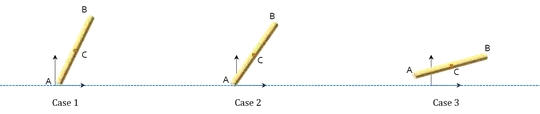

Consider an initially vertical thin rod of mass $m$ and length $L$ (i.e. with one end touching the ground) that is allowed to fall. Assume no friction between the rod and the ground and that gravity is uniform. Will one end of the rod always remain in contact with the ground?
I've borrowed the graphic above from this post which seems relevant enough to what my question is asking. I tried to condense the main features of my question into the more textbook-y sounding version above, but the gist of it is
  1. Under what conditions can a sliding rod enter into case 3 (in which the normal force vanishes)?

In falling suppose that the rotational speed of the rod about its centre of mass reaches a value so that the end of the rod leaves the surface.
At that "instant" there is then no net torque on the rod about its centre of mass and so the speed of rotation of the rod is now constant but the downward speed of the centre of mass of the rod is still increasing.
At the next "instant" of time the end of the rod hits the surface and the process (might) repeats itself.
This "hand waving" argument leads me to believe that the rod will always stay in contact with the surface.
I did an experiment but not having a frictionless surface or a suitable lump of ice, I used $30\,\rm cm$ and $60 \,\rm cm $ steel and $1\,\rm m$ wooden rulers falling onto a stainless steel sink surround surface.
There was no evidence of the ends of the rulers leaving the surface as they fell.
