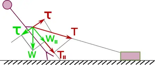

they are moving at the same speed and pulling the same weight (i.e. me) as before
It's not that simple.You will notice that while keeping your dog steady you are leaning back. Degree of leaning back depends on the type of dog - more massive dog / it's power - bigger leaning will be. This game is a bit similar to Tug of War. Who wins ? The ones who have more strength :
Now, let's get to the Physics of this game :
Dog forces are colored in red and your forces are colored in green. Several things happens when dog tries to pull you more aggressively and you lean back because of it :
  • Dog induces torque $\tau_{dog} = T_{\perp} \cdot H_{_{COM}}$
    here $T_{\perp}$ - tension force perpendicular component to your body
    $H_{_{COM}}$ - your height until Center Of Mass
  • You induce torgue $\tau_{man} = W_{\perp} \cdot H_{_{COM}}$ which is caused by perpendicular component of your weight
    your torgue direction is with an opposite sign than that of dog's
  • your static friction force experienced by your foots is : $$ F_s = \mu_s\left(|W_{\parallel} + T_{\parallel}|\right) $$ That's why your dog can't do anything about it - by leaning back it's easier for you to hold-on dog steady, because you convert part of it's tension force against him itself - to your static friction force, which it needs to overcome to be able to move. But hence, greater pull will induce even more bigger static force.
