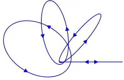

In Newtonian mechanics, if the object has any transverse velocity at all (i.e. motion not directly towards or away from the singularity), it will miss it, passing it at a minimum distance and then returning outward. This shows objects starting from the same maximum distance but with different transverse velocities.
ellipses
In the limit, with no transverse velocity, the object "bounces" off the singularity. At the point of contact it has infinite acceleration.
In general relativity, this doesn't apply. Once it falls inside the event horizon it doesn't come out, even if it has transverse velocity. As said above, it becomes tricky to define acceleration inside the event horizon. But you can still define the tidal forces locally, and these do go to infinity (as they would in the Newtonian case as well).
