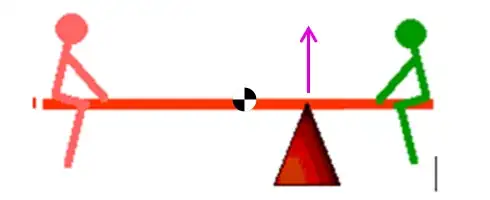

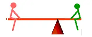

For example, say the green man and the pink man weigh exactly the same, but the green man is half as far from the pivot point as the pink man is. The rod will rotate towards the pink man.
Why?
Why?
The answer is because the pivot force acts away from the center of mass, causing a rotation.
fig1
So now your question is
  • Why is there only translation (no rotation) when the line of action of a non-zero force goes through the center of mass?
The answer to that has to do with the definition of the center of mass. by definition, if you apply a small force on every particle in a body, it is equivalent to the total force through the center of mass. Hence why it is called center of gravity sometimes, since every particle of the body experiences gravity in the same way.
And you can intuitively understand that if all the particles experience the same small force, the body is not going to rotate. It is pushed equally everywhere in a parallel fashion.
In this scenario, the center of mass is the unique point in space where a single force through it is equivalent to a uniform distributed force over the entire body. In both cases, no rotation exists.
