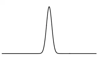

So, we have two masses, $M$ and $2M$ at opposite ends of a bar. Imagine we tap the middle of the bar with the hammer. This creates a momentary deformation at the site of the impact. This deformation causes a wave pulse (more accurately, a stress wave) to travel in both directions along the bar, away from the point of impact. See below for an illustration:
impulse separating into two waves
Picture from: https://www.acs.psu.edu/drussell/Demos/Membrane-vs-String/Membrane-vs-String.html
Now, what happens when these pulses reach the masses? They will put equal forces on the masses since the waves are identical. So, the larger masses will accelerate more slowly and lag behind the lighter mass. The bar is stiff, so it doesn't change length, meaning that it must rotate for the larger mass to lag behind.
Now, if the bar is hit closer to the larger mass, the wave pulse reaches the larger mass first due to the shorter distance. So, the larger mass gets a head start to move ahead before the smaller mass catches up due to its larger acceleration. There's a whole analysis to be done here regarding reflected waves (see picture below) and the timing of such to get Newton's Third Law to work out and to show that the proper point to hit for no rotation is the same as that derived from torque equations.
