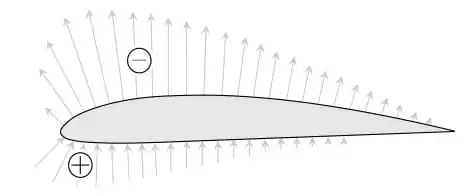

In the case of airfoils (figure 1) for instance the lift is generated by simple pressure differences according to Bernoulli's equation (only part is though directly caused by the shape of the airfoil and most by changing the angle of attack which could also be seen as "directing air downwards"): The flow is slowed down on the upper side and accelerated on the lower resulting in a lower pressure than the free stream on the upper side and a higher pressure on the other side resulting in a net force upwards. Contrary to what you might expect the low pressure part (under reference pressure) generally accounts for approximately $\frac{2}{3}$ of the entire lift while the high pressure only for the other third. Although this is perceived as suction in terms of the relative pressure the actual magnitude is still positive: it is still compression force. The lift (which may also be seen in terms of circulation) is only a result of a difference in pressure!
                Schematic pressure distribution around an airfoil.
