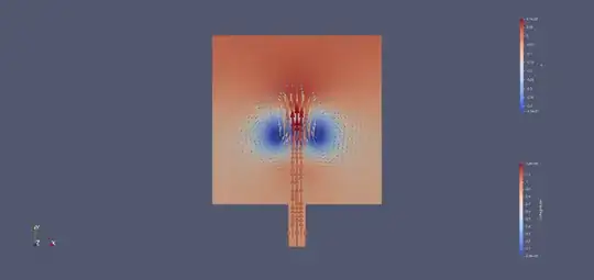

(A rough simulation by OpenFoam told me that two vortices immediately are shaped on each side of the stream head when it enters into the large space. Would these vortices prevent the stream spreading out?)

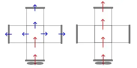

To make the problem easy, I construct a small model which has 4 openings like this. A brief model
Putting a fan at the bottom and starting to inhale air, there are two possibilities:
  1. Air spreads out all directions
  2. A straight flow is shaped
two choice for inhaling
Both of them satisfies the continuity equation. Therefore we should check only whether these situations are stable and satify the Navier-Stokes equations or not.
The wrong one is former one of course, but why? Now we estimate the situation 1 is stable, and will reach a conflict. considering incompressible 2D-Navier-Stokes equations: $$ \frac{\partial u}{\partial t} + u_{x}\frac{\partial u}{\partial x} + u_{y}\frac{\partial u}{\partial y} = -\frac{1}{\rho}\nabla p $$ We estimate it stable so don't need the first term: $$ u_{x}\frac{\partial u}{\partial x} + u_{y}\frac{\partial u}{\partial y} = -\frac{1}{\rho}\nabla p $$ we can see the convective term and pressure field form directly each other. Roughly speaking, air is accelerate/decelerate according to pressure gradient like this (red is higher):
a pressure distribution
But this has a problem. Because the outside pressure of these opening are same, there must be pressure gradient at top opening:
p distribution 2
therefore, it can't be stable. The high pressure inside the pipe releases by accelerating air due to the pressure gradient at the top, then eventually it reaches the situation 2.
When it comes to extracting, also two options are here.
  1. Air gathers from all directions
The wrong one is later this time. in the situation 2, the air at top opening should be accelerated without the fan, and only available resource is pressure gradient. Therefore, there must be pressure gradient outside around the top:
p dist3
As shown in the figure, this condition has to make pressure gradient at side as well which excites the flow from outside to inside, and it goes to situation 1.
