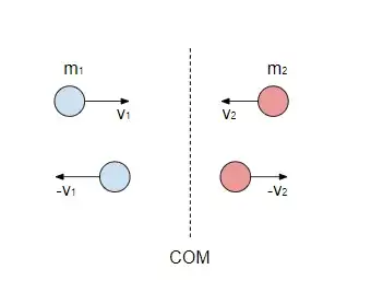

Consider the collision in the centre of mass frame, i.e. in the frame where the total momentum is zero. In that frame the collision looks like this:
COM frame
In this frame the average velocities of the two masses are both zero.
Now suppose we switch to a frame in which the COM is moving with some velocity $u$. In this frame the initial and final velocities of mass one become $v_1 + u$ and $-v_1 + u$ respectively, so the average is just the COM velocity $u$. The same argument tells us that the average velocity of mass two is also the COM velocity $u$. So what we find is that the average velocities of the two particles are aways equal and always equal to the COM velocity.
