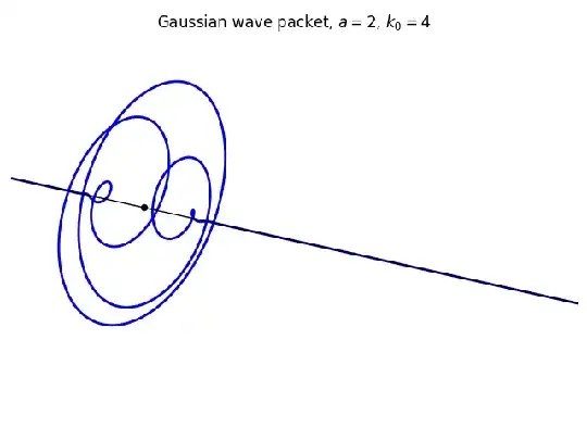

Now I actually asked a question about what really oscillates as the photon propagates, and the answers say, that it is the wavefunction that oscillates as a Gaussian wave. The photon is the excitation of the photon field, and that excitation's wavefunction oscillates as a Gaussian wave.
The strange focus on "oscillation" in the question is also beside the point. The wavefunction that models a freely travelling particle is usually a Gaußian wavepacket. This moves, but it does not "oscillate".
