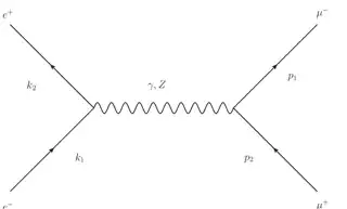

The theoretical model to understand the data is called standard model of particle physics, validated by the LEP data. This uses quantum field theory, and there are no two gammas involved in the generation of the many pairs. It uses Feynman diagrams, the first order (in the perturbation expansion) of which is with the exchange of a virtual gamma or Z, for the production of muon pairs, for example.
mumu
