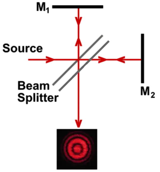

With coherent light from a laser one can assume that the path lengths of a Michelson interferometer are equal (for the purpose of your question) and due to the narrow bandwidth of the laser light one can also assume low dispersion (equal path lengths through the glass).
With everything assumed to be equal the only difference between the two paths that the light travels is:
There is a phase change for a reflection when a wave propagating in a lower-refractive index medium reflects from a higher-refractive index medium, but not in the opposite case.
Michelson interferometer fringe formation
Notice that the light travels through the glass twice, once from air to glass to mirror, and once from mirror to glass to air; one direction has increasing index and the other doesn't.
