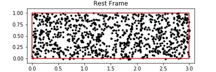

To illustrate this, I've randomly generated a 1000 particles bouncing in a 3x1 box with Maxwell-distributed velocities:

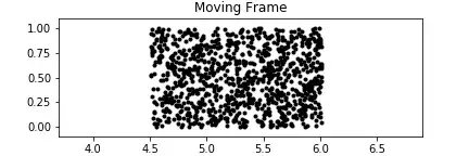

I've saved the worldlines of all the particles and applied the Lorentz transform with $\gamma=2$ to each of the particles. Plotting the resulting coordinates, I've got this:
Above I've kept the scale size of both scales and made sure that the center of the scale is at the center of the resulting particle cloud. You can see that the density has, indeed, increased. Notice that the velocities of the particles along the x-axis are changed in respect to the bounding volume -- it is not a Maxwell distribution anymore.
In the moving frame, the container has a liquid but in the rest frame, the container is filled with a solid.
As for your thought experiment, you can apply this reduction to Lorentz transformations to realize that there is no way you can get dynamic motions of individual particles of a liquid and then Lorentz-transform them to get static (relative to each other) positions of the same particles in a solid body.
