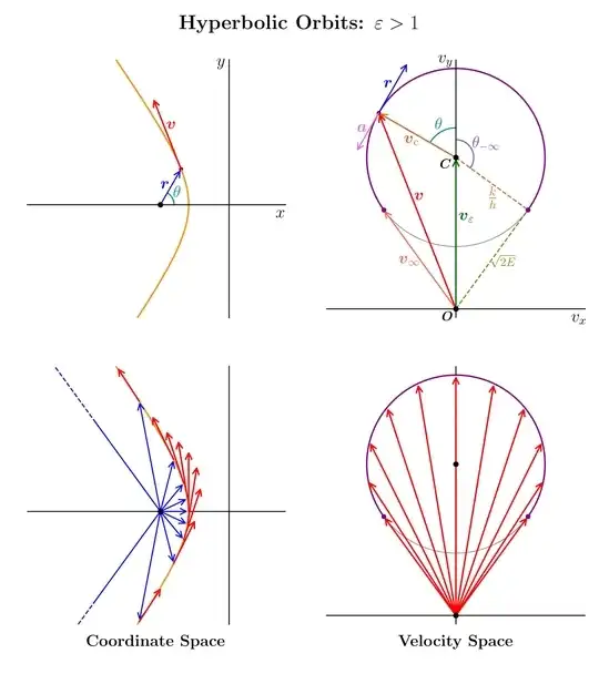

For $0\leqslant \varepsilon < 1$, the energy is negative and the orbit is bound; for $\varepsilon > 1$, the energy is positve and the orbit is unbound. We can see what happens if we write the velocity $(12)$ in cartesian coordinates:
\begin{equation} \boldsymbol{v} = -\frac{k}{h}\sin\theta \boldsymbol{e}_x + \frac{k}{h}\left(\cos\theta + \varepsilon\right)\boldsymbol{e}_y. \tag{18} \end{equation}
If $\varepsilon = 0$, the orbit is circular. If we increase the energy for fixed angular momentum, we increase $\varepsilon$. The object gets an extra boost in the $y$-direction and will deviate more and more from a circle. For $\theta > 0$ and $\cos\theta > \varepsilon$, we have $v_y > 0$ and the object will move away from the $x$-axis. If we want the object to return, $v_y$ needs to become negative at some point. This will happen if $\cos\theta < \varepsilon$ for some values of $\theta$, which is only possible when $\varepsilon < 1$.
Therefore, if $\varepsilon > 1$ the object will escape. At infinity, we find from $(15)$ and $(18)$
\begin{align} \cos\theta_{\pm\infty} &= -\dfrac{1}{\varepsilon}\\ \boldsymbol{v}_{\pm\infty} &= -\frac{k}{h}\sin\theta_{\pm\infty} \boldsymbol{e}_x + \frac{k}{h}\left(\cos\theta_{\pm\infty} + \varepsilon\right)\boldsymbol{e}_y. \tag{19} \end{align}

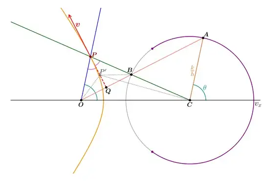

Why are these orbits conic sections? I can't think of an intuitive answer. You can do the algebra starting from $(15)$; see SuperCiocia's answer (note that his version of the equation has a minus sign in the denominator, because he defined $\boldsymbol{v}_\varepsilon = -(k/h)\varepsilon\boldsymbol{e}_y$). I will use a different approach and offer a geometric proof. Richard Feynman famously did this for elliptical orbits in his Lost Lecture (see also this post); I will use a similar idea for hyperbolic orbits.
First, let us examine the orbits in velocity space. That is, we plot the velocity vectors in a $(v_x, v_y)$-coordinate system. From $(10)$, it follows that the velocity vectors must lie on a circle that is offset in the $v_y$-direction. The plots below show the orbits for ellipses and hyperbolae, both in ordinary coordinate space and in velocity space.
There's a certain irony here: ancient philosophers were convinced that the planets were manifestations of the divine and had to move across the heavens on perfect circles; when observations showed that they didn't, people desperately tried to remedy the situation by adding epicycles, which over time became a mess. It turns out that they had been looking in the wrong place: if they had been able to map out the planets' velocities, they would've found their divine circles!
The crucial difference between elliptical orbits and hyperbolic orbits is that in the former case the origin of the $(v_x, v_y)$-coordinates $O$ lies inside the circle ($v_\varepsilon < v_\text{c}$), and in the latter case outside ($v_\varepsilon > v_\text{c}$). Also note that for hyperbolic orbits the velocities don't sweep out a full circle, but a circle segment between $\theta_{\pm\infty}$ (the purple arc on the velocity diagrams).
On to the proof. First, we rotate the velocity diagram clockwise $90^\circ$, so that it looks like the figure below:
Take a point $A$ on the circle. The line $OA$ intersects the circle in a second point $B$. Then, we draw a line through $CB$. Finally we draw a line through $O$ parallel to $CA$. This will intersect the line through $CB$ in a point $P$. The triangle $ABC$ is isosceles. Since $AB$, $BC$, $CA$ are parallel to $OB$, $BP$, $PO$ respectively, the triangle $OBP$ is also isosceles.
Therefore $|OP|$ = $|BP|$, and $|CP|-|OP| = |CP|-|BP| = |CB| = k/h$, which is constant, for every point $A$. This means that $P$ traces out a hyperbola with foci $O$ and $C$.
Furthermore, the line $PQ$ perpendicular to $OA$ bisects the angle $\widehat{OPB}$. For every other point $P'\neq P$ on $PQ$, we get $|CP'| - |OP'| < |CB| + |BP'| - |OP'| = |CB|$. So the line through $PQ$ only intersects the hyperbola in one point, $P$, and is therefore a tangent line to the hyperbola.
But since we rotated our velocity diagram $90^\circ$, the corresponding velocity vector is now perpendicular to $OA$ and parallel to $PQ$, and thus also tangent to the hyperbola. And because the velocity vectors are tangent to the orbit, it follows that the orbit is also a hyperbola. QED.
