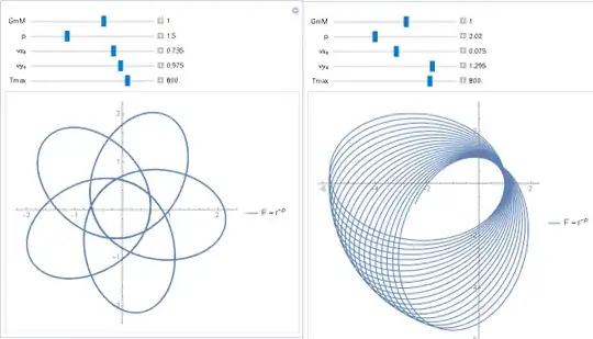

Possibly also will be interesting to try Wolfram interactive plot with numerical solution for adjusted gravity law. It's possible to get most of the edge cases (~real precession, circular, instable closed, d < 3 edge case).
It's not dimension simulation, but gives stable orbits for "4D" law as well.
Examples
