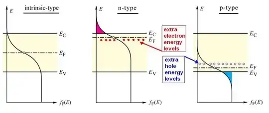

The key point is the fact that, while in the intrinsic material the electronic states are organized in a valence band and in a conduction band separated by a gap, in a n-type material (for example) there are more electronic states lying in the middle of the intrinsic gap, typycally very close to the conduction band. These electronic states appear as a consequence of introducing impurities in the lattice structure of the material. In a n-type material, the total number of electrons is also larger than in the intrinsic case, because the impurities have more valence electrons than the ions of the intrinsic lattice, so at zero temperature, not only the valence band, but also all these new electronic states are fully populated.
Since the gap between these "new" states and the conduction band is much smaller than the gap between $E_V$ and $E_C$, at a given temperature the fraction of electrons populating the conduction band is much larger than in the intrinsic material, and the Fermi function is modified as shown in the central panel of the figure. In turn, the energy at which the Fermi function is $1/2$ (the Fermi level!) is closer to $E_C$ and further from $E_V$, while in the intrinsic material it is right in the middle, due to the particle-hole symmetry.
