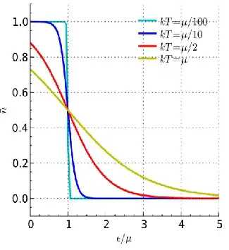

If there is a temperature dependence, then why does $\mu$ in the graph below (which to the best of my understanding is exactly $E_F$) remain constant in the different curves (i.e. they all intersect at the same point)??
F-D distribution

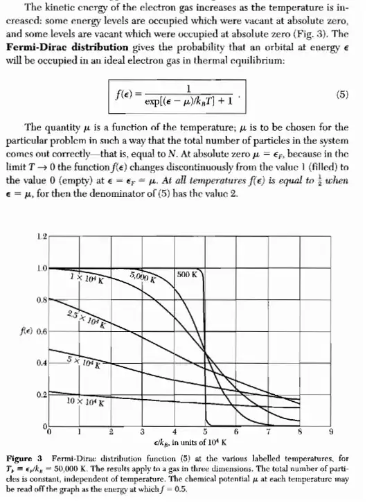

In my comment I refer to this figure: F-D distribution
taken from Charles Kittel (8th edition, page 136)
