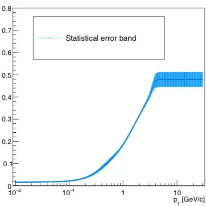

Let's call the method of drawing a statistical fit band and Method A:
A fit usually is defined by $$\chi^2:=\sum_i(\frac{f(x_i)-y_i}{\sigma_i^{stat}})^2.$$ After a fit on a dataset with statistical uncertainties, we can extract the covariance matrix of the fit parameters (no matter what analysis tool you use, for example, CERN ROOT). Let's call the eigenvectors of the covariance matrix are $\vec{v}_i$ and eigenvalues $\sigma^2_i$, due to semi-definitiveness. Then we can generate Gaussian variables $\epsilon_i$ and make the fit-parameters shift by the combination $\sum_i \epsilon_i \sigma_i \vec{v}_i$. For each random-generation, we have a fit-function curve. Then we can Monte-Carlo curves to get a fit-band. See picture below. enter image description here

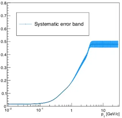

On the other hand, we have Method B (data-shuffling method): It's usually applied to systematic uncertainties. Before fit, we simply shift our data by $y_i\rightarrow y_i+\epsilon \sigma_i^{sys}$, where $\epsilon$ is a Gaussian random variable. We can do this many many times, then get a bund of curve. See the picture below is the 1-$\sigma$ band of those curves.

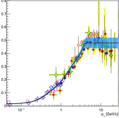

If we add them in quadrature (original data also shown), we have: enter image description here

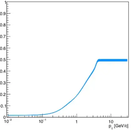

By minimizing it, we have the best fit parameter and the best $\epsilon$, tell us how datasets should shift. The band will be defined from the error of parameters such that $\Delta \chi^2=1$. Use method A again, we have enter image description here
See? The "total" error band by method C is even narrower than the pure statistical blue band in Fig 1. Not to mention comparing with Fig 3.
