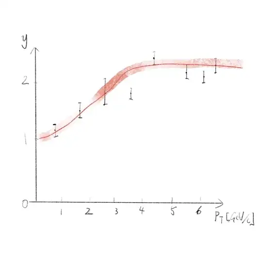

Suppose that I have a set of data with 8 points x={x0,x2...,x7} (in my example, x-axis is transverse momentum), y={y0,...,y7}, and statistical error bars ey={ey0,...ey7}. Using any software that is based on least $\chi^2$ method (for example, CERN ROOT) and is fed with some fit function $f(x;\vec{p})$ (here, let's assume we have 4 parameters), we would get the precise value of p={p0,p1,p2,p3} and their uncertainties err_p={errp0,errp1,errp2,errp3}.
Now here's the question, how can I draw a band that specifies the statistical uncertainties of this fit function, as illustrated by the red band? Please also give the underlying reason briefly, or maybe some paper that documented this problem well.
  • enter image description here
