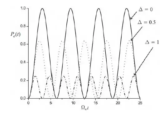

The plot of Probability vs time for various values of $\Delta$ is given enter image description here
The question is when detuning factor $\Delta$ is non-zero i.e, $\Delta$ increases the amplitude of the probability decreases and the time taken for revival and collapse decreases. Physically why probability decreases and frequency of collapse/revival increases because of increasing $\Delta$?

If however $\Delta \ne 0$ the picture becomes more interesting, because we have to choose some initial conditions to solve the equations. Usually we take $c_g(t=0)=1$ and $c_e(t=0)=0$, which breaks the symmetry of the two equations. Thus the atom periodically reaches this initial state, however, it never reaches the "fully excited state". Using the two oscillations from above, the atomic and the laser, we can come up with the following simple picture: If these frequencies are not equal, the two oscillations are not synchronised. Thus, if we start with the same phase at $t=0$ the electric dipole moment of the light excited the atom. However, with time passing the two oscillations build up a phase difference, which grows in time. At a certain point in time the two oscillations are in "opposite direction". Thus, instead of exciting the atom, the light bringst it back into the ground state.
However, the most interesting feature for the $\Delta \ne 0$ case is that the Rabi frequency increases with increasing detuning, $\Omega = \sqrt{w^2_0 + \Delta^2}$. Using the phase shift picture, one can argue that the detuning can only accelerate the atomic oscillation.
