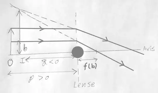

EDIT: I'm thinking about this kind of rays, with their focal length dependant on the impact parameter: enter image description here
