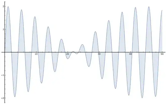

I have a question that appears to be related to the beat frequencies of multiple oscillatory signals. Suppose I have $n$ number of sinusoidal waves, each of which follow $ sin(2 \pi \frac1\tau t+\phi)$ and imagine that we add a variability to the frequency, such that $\tau$~$N(\tau,\sigma^2)$.
At time $t=0$, all $n$ waves will be in-phase, following a divergence to out-phase and, depending on the number of waves and their difference in frequencies, a return to in-phase.

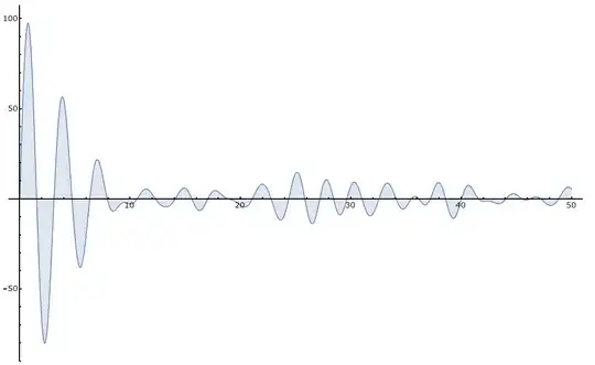

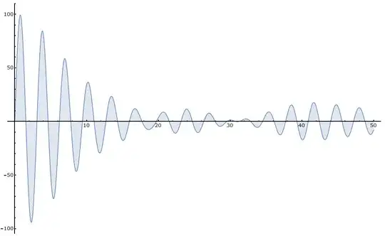

I've ran a couple of simulation in an attempt to gain some insight into how the number of oscillatory signals and the magnitude of noise in $\tau$ affects the capacity for the a population of signals to eventually reach a state in which they are in-phase.
I visualized the degree of "in-phase"ness of a population of signals by summing the signals' amplitudes (highest absolute value of the sum should indicate phase matching).
The sum of 2 signals with $\tau$~$N(\pi,.07\pi)$ enter image description here The sum of 100 signals with $\tau$~$N(\pi,.07\pi)$ enter image description here The sum of 500 signals with $\tau$~$N(\pi,.07\pi)$ enter image description here

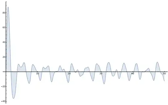

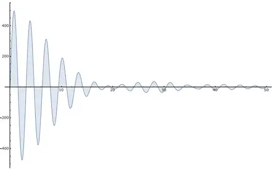

I also varied $\tau's$ noise as:
The sum of 100 signals with $\tau$~$N(\pi,.14\pi)$ enter image description here The sum of 100 signals with $\tau$~$N(\pi,.3\pi)$ enter image description here
So my question is has anyone encountered any theory related to the apparent phenomenon where there seems to be an exponential convergence to a state of asynchronous that is dependent on the number of signals being considered? Also, the magnitude of the noise of the frequencies seems to dampen the approach to asynchrony.
