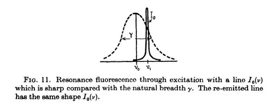

The case of near-monochromatic radiation (compared to the natural line width) can not be described by separate absorption/emission events anymore. It has to be described as resonance scattering process which is a coherent single-quantum process. This is derived in detail in §15 (Resonance Fluorescence) of the book 'The Quantum Theory of Radiation' by W. Heitler, which can be found on the Internet Archive.
atomic line width
In this case it is not possible to say in which energy state the atom is, and thus you can not really speak of a transition either. You can do this only in case of an incoherent re-emission i.e. when the atom is disturbed by other processes (e.g. collisions). In that case you would observe the natural line width again.
