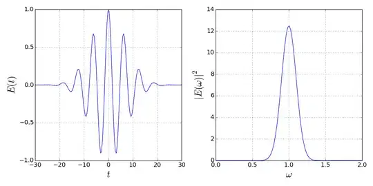

So my advice is to think about it in terms of wavepackets. $\langle b^\dagger_{\textrm{in}}(\omega) b_{\textrm{in}}(\omega) \rangle$ gives you the number of photons per unit frequency at frequency $\omega$ in the wavepacket. $\langle b^\dagger_{\textrm{in}}(t) b_{\textrm{in}}(t) \rangle$ gives you the number of photons per unit time at time $t$ in the wavepacket. Here is a picture (source):
http://cvarin.github.io/CSci-Survival-Guide/fft.html
The picture is for classical fields, so you do not have the whole business with expectation values, but the principle is the same. $|E(\omega)|^2$ is the intensity per unit frequency at frequency $\omega$, $|E(t)|^2$ is the intensity per unit time at time t.
Summary: after stripping away the weirdness of the definition of input operators and the interaction picture, this is really just Fourier transforming wave packets.
