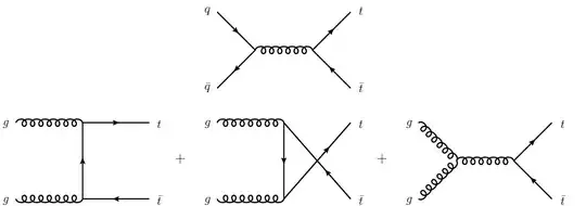

EDIT: A great response explained that annihilation to a gluon is impossible because it does not conserve colour. However I have just seen Feynman diagrams on google:enter image description here
which has this exact process occurring! And it also has a free gluon (in the final diagram) which is not possible for a non-colourless gluon, i.e. one that actual interacts/exists?

Annihilation through a single gluon can't happen because the gluon has a colour+anticolour charge, whereas the initial meson is colourless. The gluon has to have a charge like red-antiblue and you can't make that from a red-antired quark-antiquark pair.
