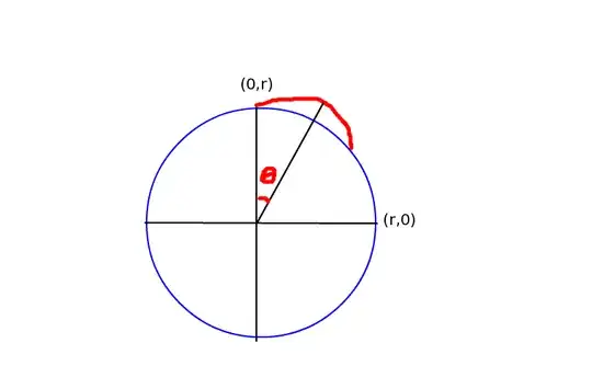

For small jumps, the answer is 122micrometers*s^3, where s is the time of the jump in seconds. I used numerical methods in Mathematica. Can someone improve on and/or verify this solution?
Consider this diagram:
I then ran the following:

The initial position is (0,r), as per the diagram above.
The initial x velocity is 2*Pi/r/d, the speed at which the equator is rotating.
The initial y velocity is vinit, by definition.

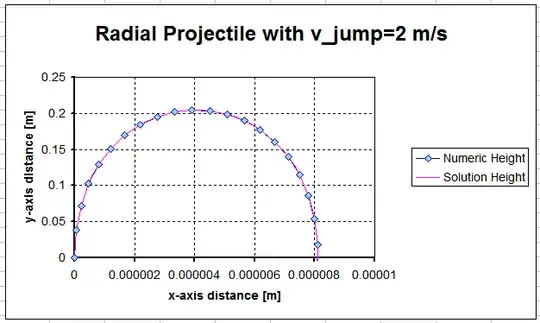

Let's do a 2nd order approximation of $\dot{y}^2$ above
$$ \dot{y}^2 \approx v_{jump}^2 + y \left( 2 \Omega^2 R - 2 g \right) - 3 \Omega^2 y^2 $$
with solution
$$ \boxed{ y(t) = \left( \frac{g}{3 \Omega^2} - \frac{R}{3} \right) \left( \cos(\sqrt{3} \Omega t)-1 \right) + \frac{v_{jump}}{\sqrt{3} \Omega} \sin(\sqrt{3} \Omega t) }$$
with time in the air:
$$ t = \frac{\pi}{\sqrt{3}\Omega} + \frac{ 2 \arctan\left( \frac{\Omega^2 R -g}{\sqrt{3} \Omega v_{jump}}\right) }{\sqrt{3}\Omega} $$
These equations match the numerical solution
Results
My excel sheet with both the numeric and the above solution is at Public Dropbox. Caution you need to have macros enabled as they are used for the numeric results.
