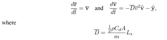

Consider the following non-dimensional equations of projectile motion in presence of air resistance,
I understand it can be numerically solved using the mid-point method, but can I also use Verlet method? Why midpoint method is more favourable in this case? Is this because the truncation error in velocity equation is of order $O(t^2)$ and $O(t^3)$ for position when midpoint method is used, which are $O(t^2)$ and $O(t^4)$ respectively when Verlet method is used? Am I thinking in the right direction?
The reason Verlet's algorithm is less suitable than midpoint method is due to the form of the force. Verlet's algorithm requires the acceleration at time step $t+\Delta t$ in order to update velocity at time $t+\Delta t$ (I refer to the so called "velocity" form of the algorithm, although the same considerations hold for the "position" form too): $$ \begin{eqnarray} x(t+\Delta t) &=& x(t) + v(t)\Delta t +\frac12 a(t) \Delta t^2 ~~~~~~~~~~~~~~[1]\\ v(t+\Delta t) &=& v(t) + \frac12\left( a(t) + a(t+\Delta t) \right) \Delta t ~~~~~~~~[2] \end{eqnarray} $$ If the force, and then the acceleration, depends on position only, $a(t+\Delta t) $ appearing in equation $[2]$ can be explicitly evaluated from the new position evaluated at $[1]$. However, if forces and then acceleration depend on velocities, equation [2] becomes an implicit equation for the velocity $v(t+\Delta t)$. It is simple to solve such equation in the case of linear forces (linear viscous friction or magnetic Lorentz force om a charged particle) but in the case of non-linear dependence on velocity things become more complex (and in 2D or 3D, much more complex) and usually other methods become preferable.
