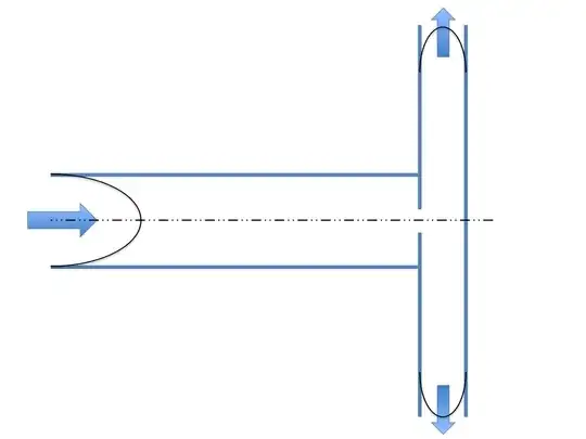

The geometry is shown below, and these are the assumptions I'm making:
  • parabolic velocity profiles enforced at the input and output boundaries, absolute velocities chosen so that mass in equals mass out.
  • no-slip conditions on all other boundaries
  • fluid is viscous but incompressible
  • static, laminar flow
  • 2D at first, then will adapt to cylindrical symmetry once that seems to work

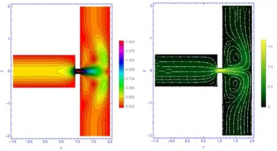

For an axisymmetric flow, I have a solution for problems with this geometry - see my answer here and here. For 2D flat geometry, I made the code as a test one. To see the solution to which to strive. When data will be received on Python, it will be possible to compare. In this example, the Reynolds number at the input $Re= 100$. Parabolic profile is set at the inlet $u=R^2-y^2,R=0.5$. Pressure is set at the outlet $p=0, y=\pm 2$. On solid boundaries everywhere $u=v=0$. To solve the problem we used NSE for incompressible flow, FEM and the method of the false transient (G. D. Mallinson and G. de Vahl Davis, 'The method of the false transient for the solution of coupled partial differential equations', J. Comp. Phys., 12, 435 (1973)). Figure 1 shows the modulus of the flow velocity and the streamline.
fig1

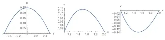

Figure 2 shows the inlet and outlet velocity profiles.
fig2

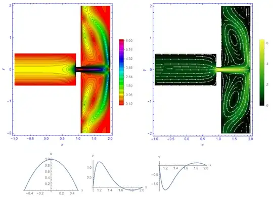

The same flow, but with an increase in the inlet velocity of 4 times as $u=4(R^2-y^2),R=0.5$. Pay attention to the outlet flow recirculation zones.
fig3
