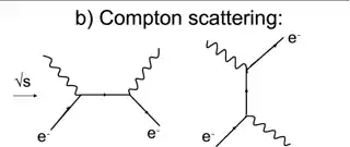

As you know, a virtual particle is a mathematical construct and is connected with the real particle of its name by the quantum numbers identifying the particle.
virtual
Also, you should know that all particles can be virtual within Feynman diagrams if they are not within the incoming and outgoing legs.
compt
In these Compton scattering diagrams it is the electron that is virtual, or the positron, when the e represents a positron gamma scattering.
So yes, antiparticles can also be mediator virtual particles in an interaction
do these mediate the anti forces?
There are no antiforces, there are attractive or repulsive end results in the interactions studied and modeled with Feynman diagrams in order to calculate the crosssections or decay rates.
The gauge bosons of the four macroscopic forces, identified with the electromagnetic/weak/strong and gravity ( if quantized) are just virtual exchanges in the lowest order diagrams in simple particle-particle interactions. It is only the quantum numbers that they carry, and their mass in the propagator which identify them. The mass is the same for Z+ or Z-, and enters in the propagator, and just the charge characterizes the virtual particle.
