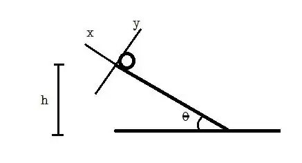

I'm new to classical mechanics and learned a new cool thing, second type equations of Lagrangian Mechanics. So, I was just testing if it really works or not. So, I made a question myself to test it, but I think that I've some problem here.
Figure
First, assume the $x$ coordinate of the ball of mass $m$. Initially, it's at $x=0$, under the influence of Gravity it should fall (assuming the setup is in such a way that Gravity is acting from downwards.)
So, the cool equation says that :
$$\displaystyle{\boxed{\boxed{ \dfrac{d}{dt} \left ( \dfrac{\partial L}{\partial {x'} } \right) - \dfrac{\partial L}{\partial x} = 0 }} \quad \dots \quad (*)}$$ Where, $L = K.E. - P.E. = ( mg \sin \theta x) - (mg \sin \theta h)\quad \dots \quad (1)$
However using the Euler-Lagrange equation (*) with the Lagrangian (1) does not give me a sensible answer, so my question is where is my mistake?
So, I've calculated K.E. here as: $K = \frac 1 2 m v^2 = \frac 1 2 m (2(g \sin \theta) x) \quad \dots \quad (\text{As }v^2 = u^2 + 2as)$
and $P = mgh = mg\sin \theta(h - x )$
The issue might be to do with using $v^2=2as$ in the kinetic energy (as suggested in comments) but I don't see why this is improper.
So, Why I can't substitute the Velocity equations in that Lagrangian Equation (That Kinetic energy part).
  1. OP's calculation (v7) violates the rule is that one is not allowed to use equations of motion in the Lagrangian $L(q,v,t)$ before all differentiations in Lagrange equations have been carried out. This is mainly because generalized positions $q^i$, generalized velocities $v^j$, and time $t$ are independent variables in the Lagrangian $L(q,v,t)$, cf. e.g. this Phys.SE post.
  2. A similar rule says that one is not allowed to use equations of motion in the action prior to variations.
