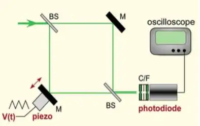

The experiment uses the Mach-Zender interferometer (MZI) depicted here (this is from figure 1 in the cited paper):
A photon enters the first beamsplitter (BS), after which it can follow either (or both!) of two paths to the next beamsplitter. The length of one of the two paths can be varied slightly using the "piezo." The detection rate at the output of the last beamsplitter depends on the difference in the two path-lengths, indicating that each photon must have taken both paths:
one may displace one of the MZI mirrors by a piezotransducer... controlled by a periodic linear voltage ramp... In this way the difference between the optical paths of the two arms of the interferometer undergoes a periodic linear change whose effect can be detected as a modulation of the light intensity recorded by a photodiode with a small entrance aperture. The interference pattern is represented via the sinusoidal variation of the photocurrent displayed by an oscilloscope.
This is essentially the same as a single-photon double-slit experiment, but with a macroscopic separation between the two paths (analogous to the "slits"):
the use of an MZI rather than a double-slit presents some methodological and didactical advantages for demonstrating quantum interference. Its spatially well-separated beams facilitate light manipulations in the two paths.
The paper also describes a variation of the experiment, in which the interference is verified by manipulating polarizations rather than path-lengths. In that context, the next excerpt says how the demonstration ensures that no more than one photon is in the interferometer at any given time (with rare exceptions):
For the single-photon experiments..., we insert strongly attenuating filters... The photomultiplier pulses are sent to an oscilloscope and to a loudspeaker so that single-photon events can be both seen and heard. ... When one of the paths of the MZI is then blocked by insertion of a large cardboard, the click rate increases in a dramatic way, thereby demonstrating that indeed each photon interferes with itself...
