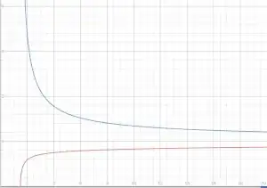

The graph of this result as a function of $r$ looks like this:
graph of doppler shifts as a function of r
So it is true, all the way down to the radius of the innermost circular orbit (not just the innermost stable circular orbit), that the observer will sometimes see the flashes at intervals shorter than 10 s, and sometimes at longer intervals. It will vary as they go through each orbit.

As a numerical example, suppose that the observer is in the innermost stable circular orbit (ISCO), with $r=3$. Then the Doppler shift factor varies between 0.71 and 2.12, which means that the 10 second period of the signals is perceived as varying from 4.7 s to 14.1 s.
Unstable circular orbits are possible for any $r>1.5$. As an extreme example, $r=1.5001$ gives a period varying from 0.041 s to 820 s.
