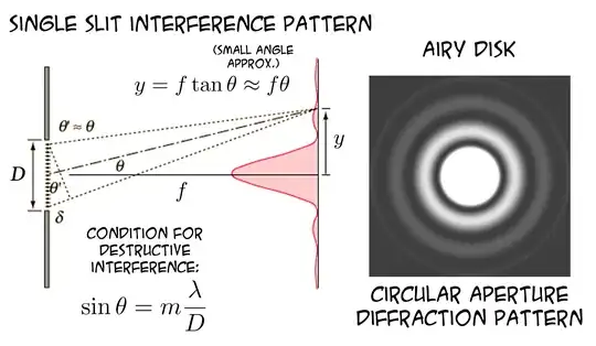

Since you are talking of single slits, here is what the interference pattern looks like:
singlsltel
The width of the slit is such as to conform with the energy of the electron so that the interference patterns would be visible.
The distribution on the right is the probability distribution of where a single electron will end up after passing the slit. You can see that maybe a fourth of the electrons will miss going through a second slit you want to set up. And that is a geometric progression. If you make the aperture smaller, less electrons will be going to the central peak.

Your proposed configuration limits further the position of the particle, but the more you constrain the position, the wider the approximation in momentum!
