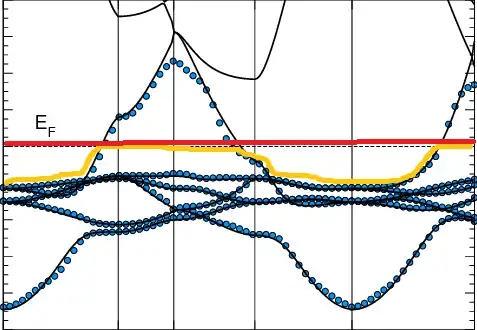

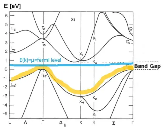

I can understand that band diagram is a diagram that relates the Energy and Momentum, E-k relationship.
But I still have vague understanding about the Fermi Surface. I cannot see the difference between Fermi Surface and Band Diagram.
  1. can I consider Fermi Surface as a Band Diagram drawn in 3D?
  2. For one element, we can draw different kind of Fermi Surface because it depends on which energy level we want to draw from its "origin" point i.e. $\Gamma$ point. Is it correct?
Cu Band Diagram
Silicon Band Diagram.

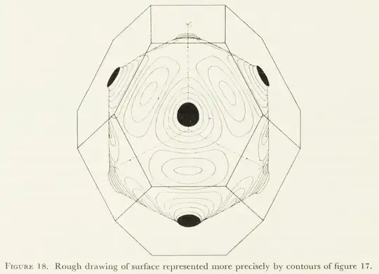

Now, if one looks at An Experimental Determination of the Fermi Surface in Copper, AB Pippard, Phil Tran A, Volume 250, Issue 979, pp 325-357 (1957) one sees a pretty spherical Fermi surface (the black areas are contact areas, these are easily mapped out with various experimental techniques):
Fermi surface of copper

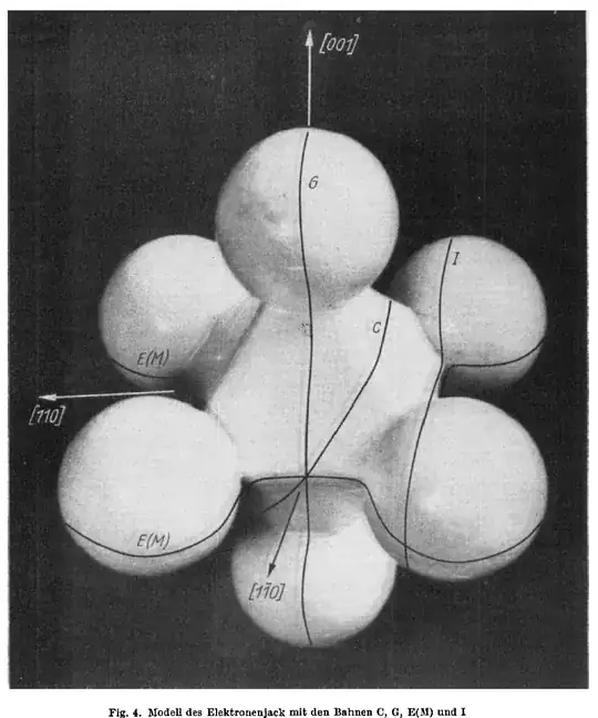

In contrast, a bcc metal such as molybdenum or tungsten might look more like this from R. Herrmann:
Iron is even worse, with disconnected pockets of electrons.
