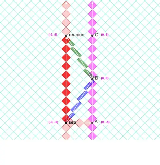

I have drawn a spacetime diagram on rotated graph paper so that we can more easily visualize the ticks along worldlines on the spacetime diagram.
clock effect twin paradox rotated graph paper home frame
So, starting at the separation event,
the ${\rm\color{red}{homeTwin\ ages\ 10\ ticks\ along\ the\ red\ worldline}}$ until the reunion event,
while the ${\rm\color{blue}{travelingTwin\ ages\ 4\ ticks\ along\ the\ blue\ worldline}}$ to the turn-around event B,
then ages ${\rm\color{green}{another \ 4\ ticks\ along\ the\ green\ worldline}}$ [for a total of 8 ticks] to the reunion event.
When the origin is at the separation event, this is the standard formulation of the problem.
Here, we have drawn it in the $\rm\color{magenta}{AlphaCentauri\ frame\ (what\ you\ call\ O'\ and\ O'')}$ with the origin at event B.
Note that, in this frame,
the event you will call A is simultaneous with the separation event, and
the event you will call C is simultaneous with the reunion event.
The AlphaCentauri-(x',t')-coordinates of the various events are shown.
In agreement with your second paragraph, $(x'_A,t'_A)=(0,-\frac{L}{v})=(0,-5)$ and $t'_B-t'_A=0-\left(-\frac{L}{v}\right)=\frac{L}{v}=5$.

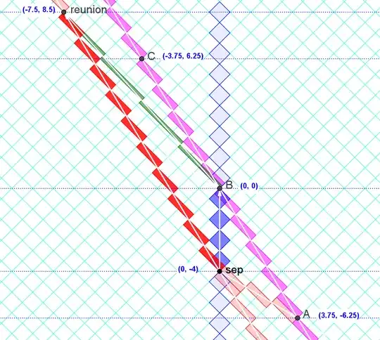

So, along this $\rm\color{green}{inbound\ leg}$, we draw another spacetime diagram (for convenience---one could learn to read everything from one spacetime diagram [on rotated graph paper]).
This leg and Its coordinate deserve its own set of "primes": O''' with $(x''',t''')$
Because the inbound speed is equal to the outbound speed, some of the coordinate-values are similar. However, if the inbound speed were different, the numbers would be different.. introducing some merely-numerical complication.
Note that the coordinates of an event in this inbound-leg's coordinates is different from that of the outbound-leg.
$(x_A''',t_A''')=(-3.75,-6.25)$ and $(x_{sep}''',t_{sep}''')=(0,-4)$ and $(x_{reu}''',t_{reu}''')=(-7.5,8.5)$
$(x_A,t_A)=(\phantom{-} 3.75,-6.25)$ and $(x_{sep},t_{sep})=(-7.5,-8.5)$ and $(x_{reu},t_{reu})=(0,4)$
Thus, for this non-inertial observer, One has to somehow splice the two spacetime diagrams together, effectively devising some rule to make coordinates in one-to-one correspondence with ALL events in spacetime. (No double counting of events and No omission of events.)
(For inertial observer, no special rule isn't needed... another indication that non-inertial observers are distinct from inertial ones.)
In agreement with your third paragraph (with $'''$), $(x'''_C,t'''_C)=(\gamma L ,\gamma\frac{L}{v})=(3.75,6.25)$ and $t'''_C-t'''_B=\left(\gamma\frac{L}{v}\right)-0=\gamma\frac{L}{v}=6.25$.
clock effect twin paradox rotated graph paper twinB frame

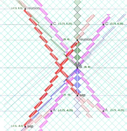

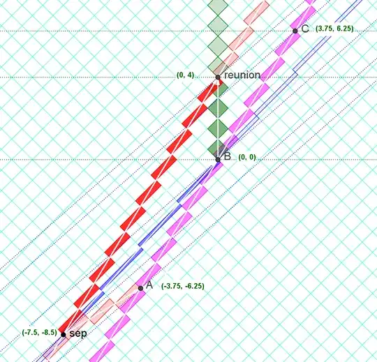

Now for your comparisons in your fourth paragraph.
I will insert this hybrid diagram (blending the previous two diagrams) which has not yet had any rule devised to splice this into a valid spacetime diagram (as described above).
(If you naively follow
the $\rm\color{blue}{outbound\ leg}$ of the travelingTwin with its lines of simultaneity, then switch at B to
the $\rm\color{green}{inbound\ leg}$ of the travelingTwin with its lines of simultaneity,
then splice the lower half of the outbound diagram with the upper half of the inbound diagram ,
note that you have omitted the midpoint (tick 5) of the homeTwin's worldline on your spliced diagram.)
clock effect twin paradox rotated graph paper hybrid blended frame
With the travelingTwin's noninertial hybrid $O-O'''$-frame,
the hybrid quantity $(t'''_C-t'''_B)-(t_B-t_A)=2\frac{\gamma L}{v}=6.25+6.25=12.5$.
Because of symmetry in the problem, $t'''_C=t_C$ and $t'''_B=t_B=0$,
so $t_C-t_A=2\frac{\gamma L}{v}=6.25+6.25=12.5$.
With the AlphaCentauri inertial $O'-O''$-frame,
the quantity $(t''_C-t''_B)+(t'_B-t'_A)=\frac{L}{v}+\frac{L}{v}=5+5=10$.
