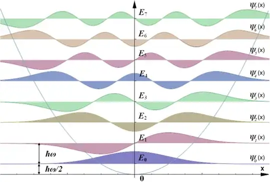

The expectation value is zero because there is a symmetry between $x$ and $-x$. If you look at the form of the eigenfunctions below, you'll see that both $\psi_0$ and $\psi_2$ are symmetric about the $y$-axis. Intuitively, this means that if you take the expectation value of either of them, or their sum (their sum will have non-trivial time evolution, but you can convince yourself that the symmetry will be conserved - there's no reason for it to prefer one side over the other), the expectation value of $x$ will be zero.
In general, eigenstates of the harmonic oscillator do not tend to have the oscillatory behavior that one might expect from classical mechanics. However, this feature is present for coherent states.
The eigenfunctions of the harmonic oscillator
