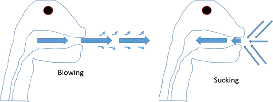

A coherent stream of air can be said to be comprised of air particles with a similar velocity magnitude and direction. For both sucking and blowing, there is a relatively coherent stream of air in your mouth.
Sucking is pulling air almost equally from all directions, into your mouth, where it becomes coherent. See illustration below. Blowing is introducing a coherent stream of air from your mouth into the air outside your mouth. In the case of blowing, the stream of coherent air that you have created will persist for some distance), at least until it reaches a nearby candle (the coherency is lost with distance due to boundary influences - see the small arrows in the blowing diagram).
Blowing vs sucking
