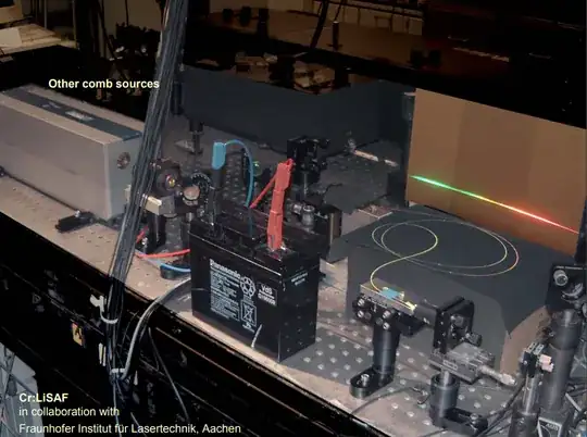

For very short laser pulses of a femtosecond or less, the frequency spread is enormous. Here is an image of a type of laser called a frequency comb with its spectrum spread out (not using a prism, but the principle is the same) onto a piece of paper, showing that it spans almost the whole visible range. frequency comb

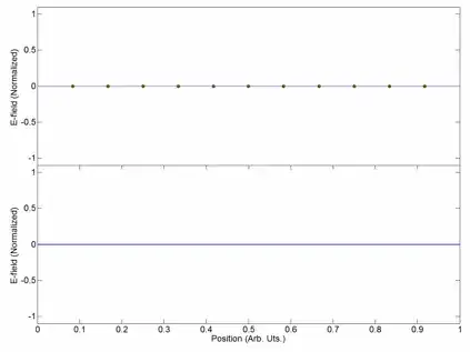

The Wikipedia article on mode locking of lasers has a useful animation (by Davidjessop) showing how standing waves of different wavelengths can add together to create a traveling pulse of light: Mode-locked laser animation
