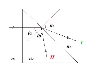

Following the asker's comments I understand his problem to be as in the following diagram:
Dispersion - reflection diagram.
For rays following path I, we get refraction:
$n_2\sin\theta_1=n_1\sin\theta_2$
Or: $\sin\theta_1=\frac{n_1}{n_2}\sin\theta_2$
For rays following path II we have total reflection:
Acc. Snell's Law, for total reflection, $\theta_2=90^0$, so $\sin\theta_2=1$.
So $\sin\theta_1=\frac{n_1}{n_2}$ and $n_1=n_2\sin\theta_1$.
Because the triangle is isosceles, $\theta_1=45^0$, so:
$\large{n_1=\frac{\sqrt{2}}{2}n_2}$
This the critical value for $n_1$, in reality to get total refection the condition:
$\large{n_1<\frac{\sqrt{2}}{2}n_2}$ must be met.
