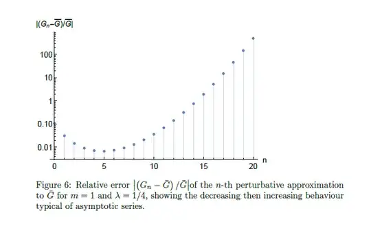

A picture is worth a thousand words. To echo @RodgerJBarlow's point, see below for an illustration (see this paper) of tendency of blowing up in an asymptotic series: enter image description here
Mathematically speaking, one can resort to techniques along the lines of Borel transformation to convert a divergent series into a convergent one.
