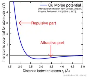

In general, if $V(x)$ is the potential energy, and $x_0$ is such that $V’(x_0)=0$ then $$ V(x-x_0)= V(x_0)+\frac{1}{2}V^{\prime\prime }(x_0)(x-x_0)^2+\frac{1}{3!} V^{\prime\prime\prime}(x_0)(x-x_0)^3+\ldots $$ so that any locally concave potential will result is an approximately linear for near the minimum $x_0$. Hence, beyond the ideal spring, the Lennard-Jones molecular potential $$ V(x)=4\epsilon\left(\left(\frac{\sigma}{x}\right)^{12}-\left(\frac{\sigma}{x}\right)^6\right) $$ will produce an approximately linear restoring force near $x_0=2^{1/6}\sigma$. The Morse potential and a whole host of others, also have a quadratic approximation (leading to linear force) but the coefficients depend on the potential. Clearly then this depends critically on “what the spring is”, i.e. on the specific molecular potential, although they all have a regime where the force will be linear. There’s a good discussion of this on this page.

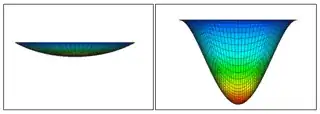

  • Sufficiently large changes in the macroscale geometry disrupt the loading conditions: A classic example here is the stiffening of a membrane under pressure (as the lateral loading transitions to stretching of the membrane material):

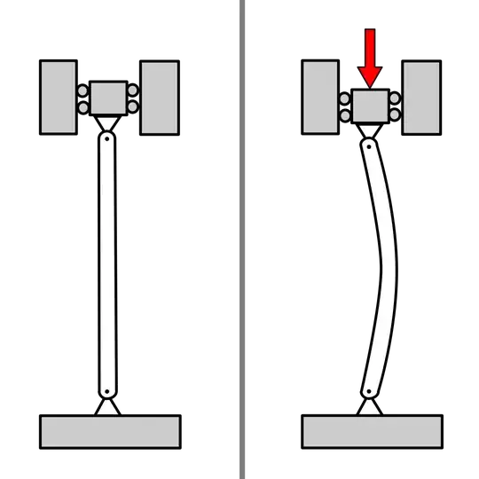

    The reverse example is the buckling of a column as the compressive loading transitions to bending:

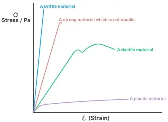

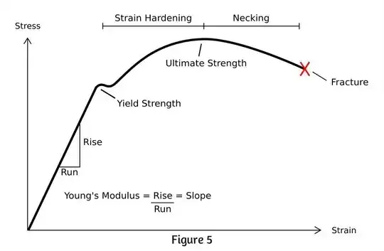

    • The material permanently deforms: In a ductile crystal, the stress might be high enough that dislocations start to move, resulting in shear slip and plastic deformation. Here, the stress-strain curve changes direction at this yield point:
      In a brittle ceramic, in contrast, the strain energy stored in the material might grow so large that it becomes energetically preferable to make a new surface, which corresponds to fracture. In this case, the linear stress-strain region simply ends:

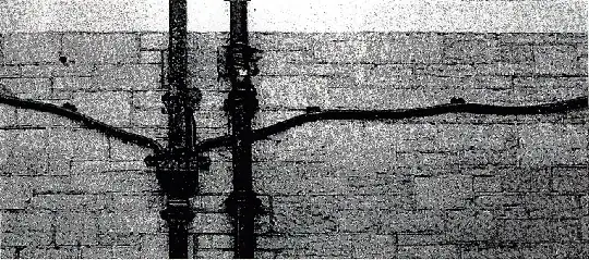

      Finally, in viscoelastic materials (and all solids are viscoelastic over sufficiently long time periods), the material will creep under a constant stress, which is clear violation of Hooke's Law. Consider the deformation of these lead pipes after decades of gravity exposure:

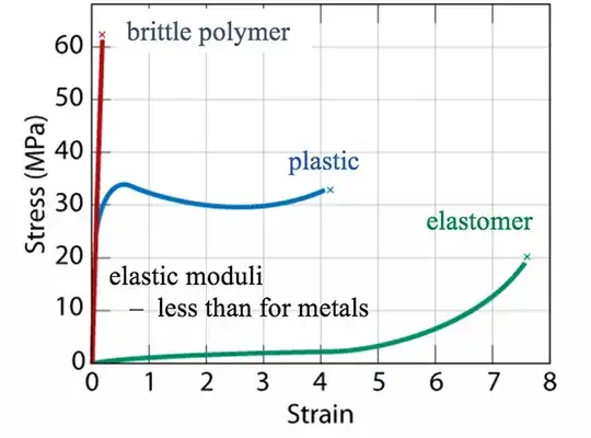

      For polymers, the kinked chains may have straightened (this is the microscale version of Reason 1 above) so that we're now pulling on the molecular backbone rather than just uncoiling the polymer. The general result is stiffening, here shown for an elastomer:
