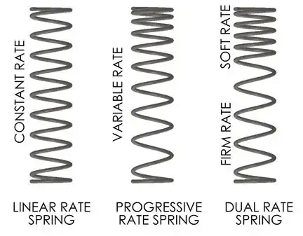

There are springs explicitly designed to deviate from Hooke's law in a repeatable and predictable manner.
enter image description here (image credit)
In this example, this is done without using the possible intrinsic non-linearities of the material. The steel itself is used well inside its Hooke-abiding deformation range in order to be acceptably reliable.
So the short answer is No.

It is possible to alter the geometry of the spring to get nonlinear springs. In @fraxinus’s answer, the progressive-rate spring has a coil that becomes “flatter” near the top. These parts twist more easily when force is applied at the end of the spring. On its own, this change in winding pitch just means that we need to take into account the different “lever arms” at different parts of the coil when calculating the total stiffness. Because they move more easily, however, the flatter coils will start to touch each other as the spring compresses; this “takes them out of play” by preventing them from compressing any more, so further displacement is distributed over a shorter section of the spring, so that the ratio between movement of the end of the the spring and the intermolecular displacements gets larger. This makes the spring force increase as faster than linearly as the spring is compressed. The exact rate at which the force goes up (i.e. the coefficients in the series that appear in other answers) depends on the winding pattern of the spring.
For the dual-rate spring in @fraxinus’s answer, the flat set of coils bottom out all at once, so that the total stiffness is the combination of the two stiffnesses (dominated by the softer of the two values) for small displacements, and then abruptly changes to the stiffer spring rate when the soft spring is fully compressed.
