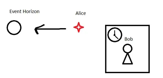

As Alice is approaching the event horizon, for outsider Bob, Bob will see that Alice's time delayed and slowly stop. I heard that even Bob waits for long time, Bob will never be able to see Alice going in to the event horizon.

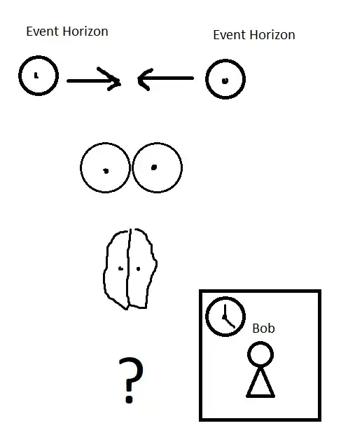

Then what happens if the two event horizon approach each other? Does it mean, in frame of outsider Bob, Bob cannot observe black hole-black hole collision since two black holes will slow down as they approach to each other. so I will only see two blackholes are slowly merging, but they will stop at their event horizon?

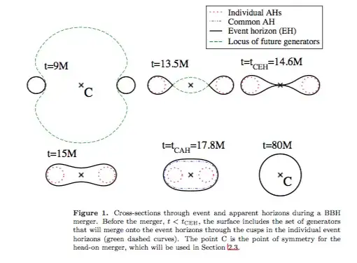

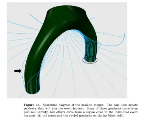

An event horizon is generally not a static thing. When two black holes merge, the event horizon evolves dynamically during the process. By definition, the event horizon encloses the set of points from which no null geodesic can escape, so the situation can be described in terms of the fates of various null geodesics. My answer to the question
Growth of black holes and the no-hair theorem
includes some intuition and some corroborating pictures (with references) that give some idea of how the event horizon evolves during the merging process. The important point here is that although Bob can't "see" the event horizon directly (and therefore can't "see" the black holes directly even before they merge), what Bob can do is see light that passed close to the event horizon, say from a distant source, or even from Bob's own flashlight because light can wrap around a black hole one or more times and then return to its source. If Bob is a finite distance away from the event horizon, then it takes only a finite amount of Bob's proper time for the light from his flashlight to return to his eyes, and in this way he can (in principle) "observe" the process of the merger. For convenience, the pictures from the post cited above are reproduced here:
These are figures 1 and 15 from "Revisiting Event Horizon Finders," https://arxiv.org/abs/0809.2628.
