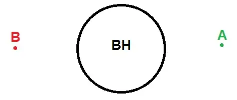

Let's assume there is a black hole, and there are two starships (A and B), hovering above the black hole at the same distance from the event horizon, but on the opposite sides of the black hole. According to the "no-hair" theorem, both starships should measure exactly the same gravitational force from the black hole. The situation is depicted in the picture. enter image description here

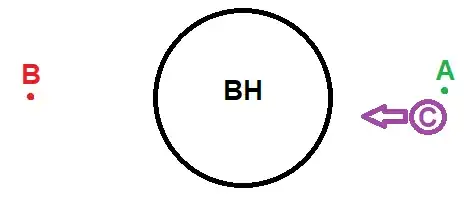

Now let's throw a very massive object C from the direction where the starship A is positioned to the black hole. As the object C is falling, the starship A should measure a greater gravitational force, because it is closer to the massive object C. Now the situtation looks like in this picture: enter image description here
According to the theory of general relativity, an outside observer should never see an object cross the event horizon - instead the object will freeze outside the event horizon. I know that the object will become more and more redshifted, and finally it will fade to black. But it should still exert a gravitational force. If it is so, the spaceship A will continue to detect a greater gravitational force, even after it stops receiving any light from the object C.
If this is right, how can a black hole ever grow and how can it consume anything? And if it somehow consumes the falling object C, how can the "no-hair" theorem be true, as you can still measure presence of C? And if my reasoning is not correct, where have I made a mistake?
