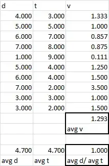

Calculate velocity ten times and then average it. If you were looking for average distance, then average the distance, if you were looking for average times, then average the times.
What you are doing doesn't even give the same number as the average velocity: enter image description here

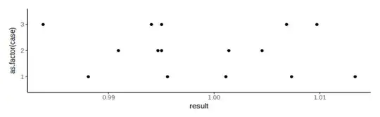

Let's test it with some simulated measurements:
df = expand.grid(case=1:3, measurement=1:5)
df$result = Vectorize(measure, vectorize.args = 'x')(replicate(nrow(df), 1), 1)
p = ggplot(df) +
  geom_point(aes(y=result, x=as.factor(case))) +
  theme_classic()
show(p)

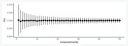

We expect repeated measurements to converge, but with diminishing returns:
df = expand.grid(case=1:1000, m=1:50)
df$result = Vectorize(measure, vectorize.args = 'n')(1, df$m)
df_sum = df %>% group_by(m) %>% summarise(mu = mean(result), sigma = sd(result), measurements = first(m))
p = ggplot(df_sum) +
  # geom_boxplot(aes(y=result, x=measurements, group=measurements)) +
  geom_pointrange(aes(x=measurements, y=mu, ymin=mu-sigma, ymax=mu+sigma)) +
  theme_classic()
show(p)

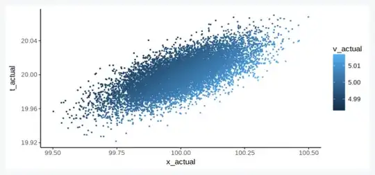

We set up the ball experiment: The ball thrower has a velocity setting (the exact value of which we don't know) and the camera has a timer setting (the value of which we also don't know). So both v and t converge to one value, but have some experiment error. We try doing several experiments:
# Set ball roller to a certain energy level (value unknown to you)
v_expected = 5
# And the camera to photograph after a certain delay (value unknown to you)
t_expected = 20
# Relative apparatus error
ea = 0.001
# Number of trials
n = 10
# Number of experiments
k = 1000
df = expand.grid(experiment = 1:k, trial=1:n)
# Roll the ball for each trial, but the machine is slightly faster or slower sometimes
df$v_actual = v_expected*rnorm(nrow(df), 1, ea)
# The camera's timer isn't very consistent either
df$t_actual = t_expected*rnorm(nrow(df), 1, ea)
# We don't know the true distance yet, but nature does
df$x_actual = df$v_actual * df$t_actual
# Visualize
p = ggplot(df) +
  geom_point(aes(x=x_actual, y=t_actual, color=v_actual), size=0.5) +
  theme_classic()
show(p)

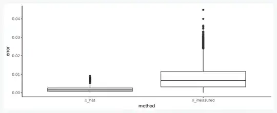

Now we try measuring our experimental outcomes:
# You try to measure the distance, but your ruler isn't very accurate
df$x_measured = Vectorize(measure, vectorize.args = 'x')(df$x_actual, 1)
# You also tried to measure the time, but your stopwatch is not the best
df$t_measured = Vectorize(measure, vectorize.args = 'x')(df$t_actual, 1)
# Number of repeat measurements
m = 20
# What if you measured x multiple times?
df$x_hat = Vectorize(measure, vectorize.args = 'x')(df$x_actual, m)
# And had multiple assistants, each with their stopwatches?
df$t_hat = Vectorize(measure, vectorize.args = 'x')(df$t_actual, m)
Of course multiple measurements are much better:
df_sum = df %>% gather(key='method', value='measurement', c(6,8)) %>%
  mutate(error=abs(measurement-x_actual)/x_actual)
# Visualize
  geom_boxplot(aes(x=method, y=error)) +
  theme_classic()
show(p)

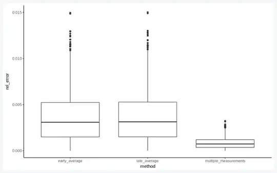

But does it matter when we average?
df_sum = df %>% mutate(v_measured = x_measured/t_measured) %>% group_by(experiment) %>%
  summarise(v_bar = mean(v_actual),
            t_bar = mean(t_actual),
            x_bar = mean(x_actual),
            v_bad = mean(x_measured)/mean(t_measured),
            v_good = mean(v_measured),
            v_best = mean(x_hat/t_hat),
            early = abs(v_bad-v_expected)/v_expected,
            late = abs(v_good-v_expected)/v_expected,
            multiple_measurements = abs(v_best-v_expected)/v_expected) %>%
  gather(key='method', value='rel_error', 8:10)
df_sum$method = fct_inorder(df_sum$method)
# Visualize
  geom_boxplot(aes(x=method, y=rel_error)) +
  theme_classic()
show(p)
