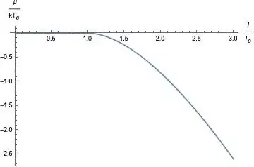

$$ \frac{\mu(T)}{kT_c} = \begin{cases} \sim 0 &\text{for } T<T_c\,,\\ ({T}/{T_c}) \log \left({Li_{3/2}}^{-1}(\zeta(3/2)(T/T_c)^{-3/2})\right) &\text{for } T>T_c\,. \end{cases} $$
As you see below, at $T=T_c(v)=2\pi\hbar^2m^{-1}(\zeta(3/2)v)^{-2/3}$, a phase transition occurs.
$\hspace{4cm}$Chemical Potential
