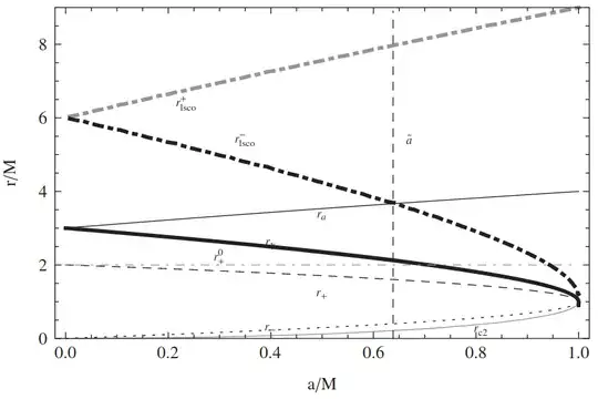

This dependence of orbital parameters on the black hole spin could be illustrated by the following image (figure 5 of the cited paper):
Fig. 5 of Pugliese et al.
Here the $r$ is a radial variable of the Boyer–Lindquist coordiantes, $r^-_\text{isco}$ is the radius of the prograde ISCO, $r^+_\text{isco}$ is the radius of retrograde ISCO, $r_\gamma$ is the radius of prograde photon sphere, $r^\pm$ are outer and inner horizon radii, while the ergosphere for all values of the spin is precisely at $r=2 M$. So orbits inside the ergosphere correspond to lower tails of solid bold line and dashed bold lines below the thin dashed dotted line.

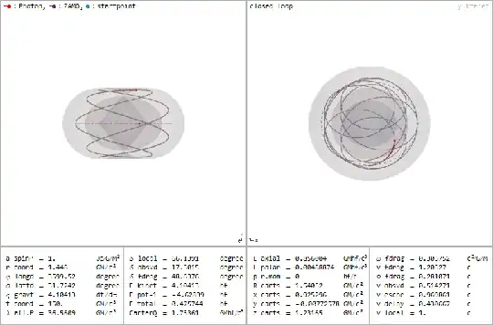

Orbits are possible, but not all of them are necessarily stable (the latter is only the case when Vr"(r)<0), if you disturb them the particle might either plunge or fly away, see Leo Stein's site for a plot of the innermost stable orbits in dependance of the spin. Here is one of the photon orbits inside the outer ergosphere (but still outside of the horizon) at r=1.448 and an observed equatorial inclination of 17.5° around a maximally rotating black hole with a=1 (for all possible photon orbits in this configuration click on the image):

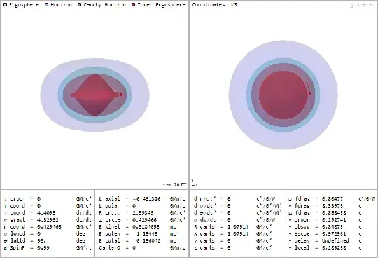

You can also have orbits inside the inner horizon if they are still outside of the inner ergosphere. It's not possible to reach such an orbit in free fall, but you can get there if you have propulsion. The real problem would be to get through the Cauchy horizon undamaged, because if you enter at the wrong angle you encouter infininte blueshift before entering the stable region. Also the total energy of the particle (kinetic+potential+restenergy) becomes negative, here you have an example of a test particle in a circular orbit inside of a black hole with spinparameter a=0.99 at r=0.429 with energy -0.136 and a local velocity of 0.189c:
inner horizon orbit
The black holes in this animations rotate counterclockwise (from West to East), the testparticle's trail goes in the opposite direction because the local velocity is retrograde although it looks like prograde due to the frame dragging. The coordinates are Kerr Schild, so the time coordinate t is finkelsteinlike.
The escape velocity in the display of the second image is of course not the velocity needed to escape the black hole (which is by definition not possible), but if you manage to get through the Cauchy horizon without getting roasted by infalling and blueshifted photons you could at least in theory escape the white hole backdoor, see Hamilton's diagrams. For other possible orbits inside rotating and/or charged black hole see Dokuchaev's work on the subject.
